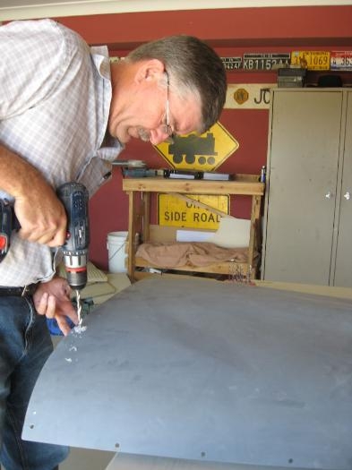

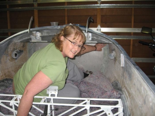

Fitted the camloks for the firewall part of the top cowling. Ended up being fiddly - had to recess the rivets as the fuse is thicker here. Made a block as a drill stop and drilled all the recesses.
Then discovered that the rivets will (of course!) pull out of the recesses and up against the rivet gun when the rivets are pulled. After some thinking, I found some larger rivets, cut the casings off and slide the casings over the pivet pull shaft so I could then pull against the casings - that worked so all finished.
Sheryl holding the receivers ....
While I rivet from the outside.
Widening the 1/8
Widening the 1/8" cleco holes to 3/8" to clear the camloks.
