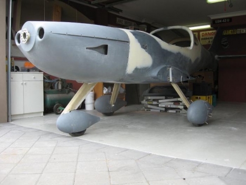

Trimmed and fitted (with flock mixture & self-tappers) the inside half of the engine air intake duct. Sanded all the ducts and did the first fill.
Fitted all the fairings and pants and did the final trimming (on-off-on-off-on-off ....) Took them all off to replace the clecoes with screws and nut plates.
And did lots of filling and sanding on the fairings ...................
Final shaping and sanding of wheel pants.

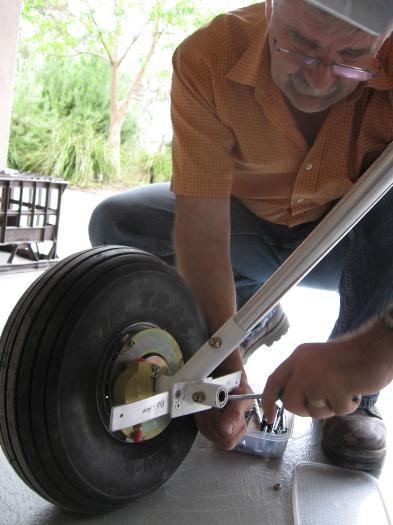

Removing pant brackets to attach nut-plates,
All fairings and pants trimmed fitted and trimmed to shape.
