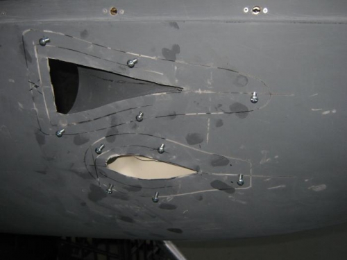

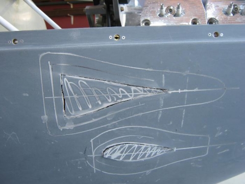

Made the cut-out for the oil cooler duct yesterday. Located and made the cut-outs for the engine air intake duct and cabin heat intake duct tonight. Screwed all 3 ducts in place.

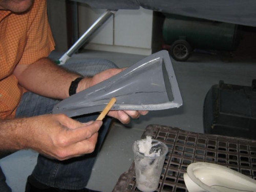

Then removed all the ducts, sanded all the flange surfaces with 60 grit and wetout all mating surfaces with resin. I then mixed the flock into the remaining resin, applied the flock mixture to the duct flanges, pressed them in place and scewed them with self-tappers.
Will remove the self tappers tomorrow morning after the flock misture has cured, but before it goes rock hard.
Duct flanges marked on the cowl - with my first cut 1/2
Duct flanges marked on the cowl - with my first cut 1/2" inside the flanges.
Applying the flock to the ducts.
Ducst held in place with self-tappers.
