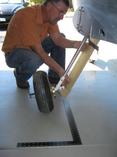

Brief Description:  Making a start on the main gear leg fairings.
Studied Peter T's fairings to try to get a good fit. The problem is that the fairings fit between fuse bottom and the axle - so you can't trim one end nicely and then cut to length. You have to estimate the angles and then cut. Once cut, the fiaring will fit in place and you can see how close your guess was - in my case it was 20mm short on one side. I glassed some of the cut off fairing back on. I then used this as a template for the other side and got that one right.
Guestimating length!

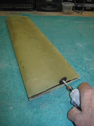

Lots of small cuts.
Lots of small cuts.

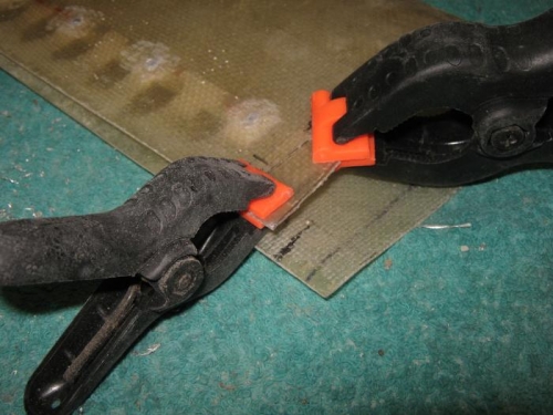

And then glassing back on again!
