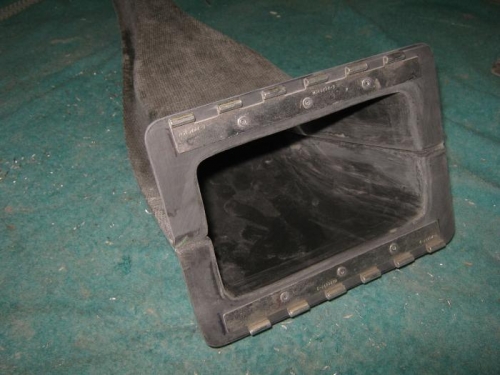

Finished the oil cooler and NACA duct assembly. Now ready to start fitting the firewall and lower cowling.

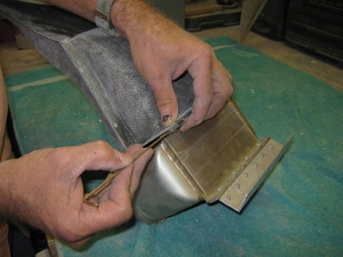

Riveting the hinges to the cooler.
Hinge leaves riveted to the NACA duct.
Sliding pins in to attach the duct to the cooler.
