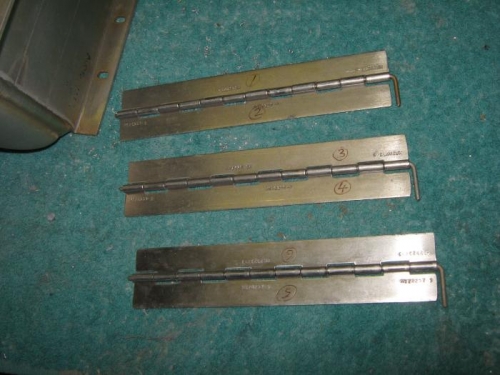

Had to buy some more piano hinge for oil cooler - cut it all to length and made up the 3 hinges. Fitted the hinges to the oil cooler. Not hard, but a little tricky to make sure the rivet heads didn't foul cooler when shut. Made up backing plates for the rivets (don't like pulling pivets against fibreglass).

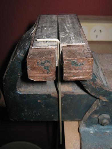

Cutting and bending hinge pins.
The 3 required hinges - complete.
