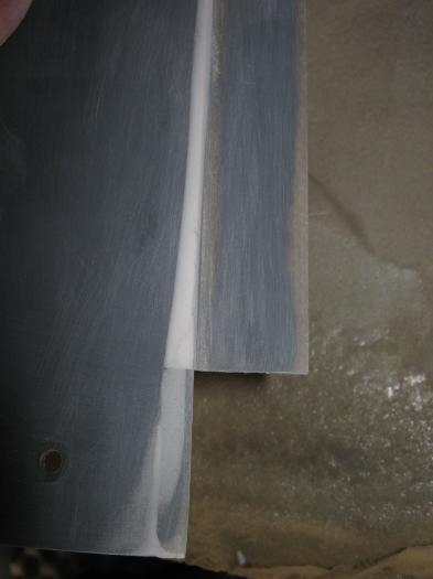

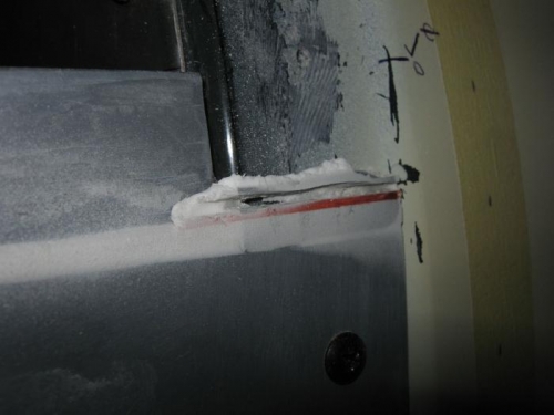

Cut the joggle from the back edge of the lower cowl so the cowl would fit more evenly to the firewall. This left a gap so I glassed a piece, then filled, trimmed and sanded it (both sides) to get a good joint. Took many fit, remove, fit cycles. Continued sanding of the fuselage.
Trimming the glassed extension.
Filling the wobble in the joggle line.
