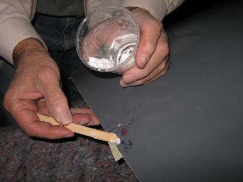

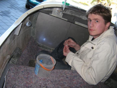

Fitted the nutplates for ther lower cowl while Robert was available - much easier with him inside holding the plates while I rivited them in place from the outside. Had to recess the rivets as the fibreglass was too thick around the firewall. Then had to make up a small tube to slide over the rivets so I could pull them in the recess. Started filling and finishing the cowls now thay are properly fitted.

Robert helping to fit the nutplates for the lower cowl.

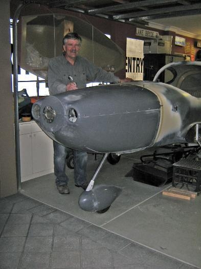

More general filling and sanding.
Cowls fitted - ready to be sanded and finished.
