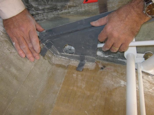

Started by cutting out the seat side support rails so they can be repositioned inboard 10mm so better support the seats. Put the first glass in to hold the rails in place (will glass properly tomorrow).

Moving the seat side support rails.

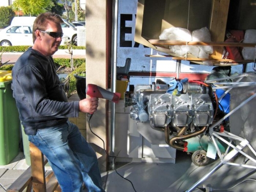

Dean relaxing - and heating the locktite 601 on the prop flange bolts.

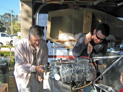

Dean holding the ring gear while I crack all the bolts.
