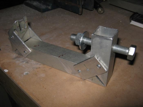

Couldn't fit the proper bolts when the engine was mounted as we couldn't compress the rubber bushes enough to get the nuts on.

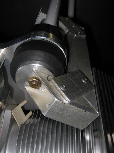

Made up a clamp to do the job. Used it - and now the correct bolts are all in.
Clamp

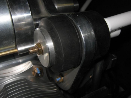

Rubber bush compressed and nut on bolt
All finished.
