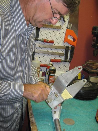

Spent 3 hours on Saturday reassembling nose gear. Removed the powdercoat so the bracket fitted better inside the nylon block.

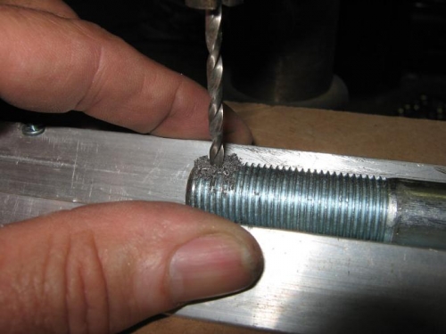

Made all the spaces tonight - 2 either side for the travel limted bolt and 2 either side for the main axle. Assembled the gear, marked the split-pin hole, then pulled apart and drilled the hole. Then assembled all. It is now ready to fit into the engine mount.
Re-assembling the nose gear.
Drilling the hole in the axle for the split pin.
