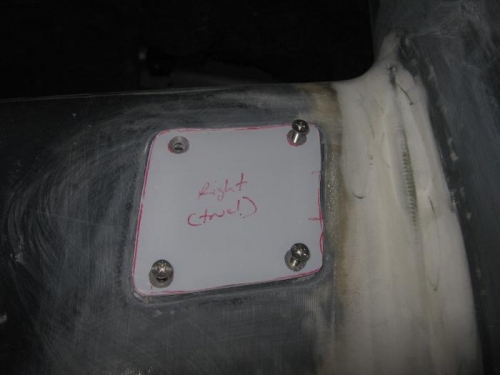

Again followed Peter T's lead and made the inspection covers on the underside of the horozontal stabilisers (to check the AOA bolts) out of 2mm clear polycarbonate sheet. Inspection can now be done by looking through the covers.

Finished cover (RHS) temp in place.
