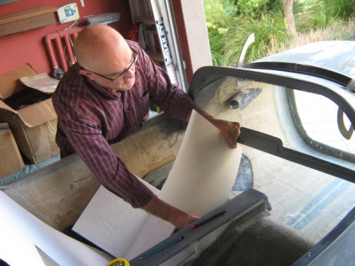

A productive day sorting the polacement of the centre console and seats. With set reference points it took quite a while to establish a reasonable location for the seats so the centre console and side rails could be attached.
We are making the console removeable - to provide better access to the flap motor area. Once the seat location was determined, brackets were made up to locate the centres console and the brackets and seat side rails were attached with 5 min resin - and given the first glass coat.

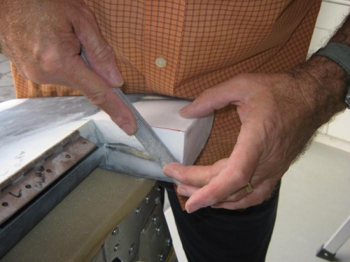

WP continued sanding while MP worked on designing a fuel console (to run between the centre console & panel). The standard fuel console looks like an afterthought - and it is a critical area - hence the design work.
MP making a console support bracket
