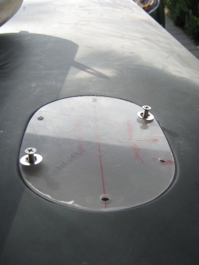

Followed Peter T's idea of making inspection covers in clear polycarbonate (makes inspection real easy - just shine a torch through the clear cover). I bought some 2mm clear poly sheet for the job.

Clear polycarbonate cover
Nearly finished.
Nearly finished.
