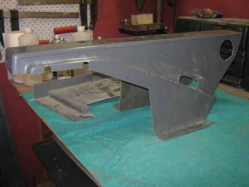

Brief Description:  Extending centre console - and more sanding ....
Falling into a pattern now - have a construction project each day - and keep on filling and sanding.
The centre console needs to be extended to provide space for the quadrant throttle. I cut the top off, used offcuts from the seat side support rails as spacers, screwed support pieces to hold everything in place, then started glassing up the inside. Fiddly job and took all morning.
Spent the afternoon doing another sand and refill of the wings and wing tips.
Console before cutting.
Extended and supported.
First layer of glass.
