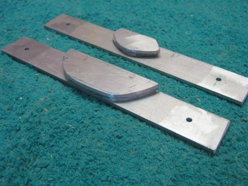

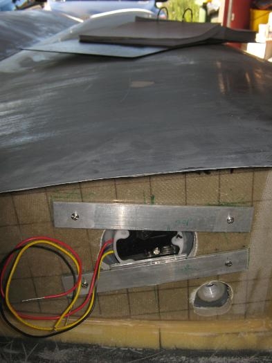

Made up the plates to hold the fuel sender units in place while the flocking went off. One of the tanks was recessed 1/4" more than the depth of the sender unit - so I had to set packers on the plates to hold the sender unit in place properly.

Plates to hold sender units
Fuel sender units glued in.
