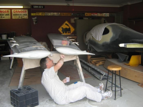

Brief Description:  Attaching wing tips
Spent the afternoon preparing the wings and wing tips - then attaching the tips to the wings. Clecoed the tips in place, then ground and sanded the joggle area - ground the gell coat from the outside joint area at the same time (ready for the glassing of the joint). Really dusty work!
Then re-attached the tips with clecoes and fitted sacrificial screws in between the clecoes (can't use the clecoes when the joint is filled with flocking).
Removed the tips again - then wet the joint area with resin and filled with flocking - then pressed the tips in place and secured with screws. Will remove the screws tomorrow morning and run the first layer of glass around the joints.
Grinding the gell coat from the joggle area
Final filling of the joint.
The fitted tip - with the temp screws
