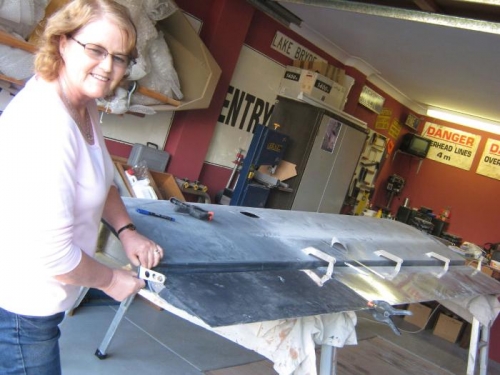

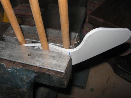

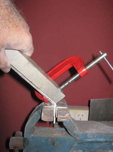

Brief Description:  Fitting aileron - part I
Trued the flap - located and mounted the outboard bracket - then measured and started bending the inboad bracket. Very slow process - you need an "S" bend so both ends are parallel and spaced apart to suit the gap between the flap bracket and the aileron hinge. Guesswork involved so slow careful progress!
Sheryl helping align the aileron.
First bend for the inboard bracket
Final bend for the inboard bracket.
