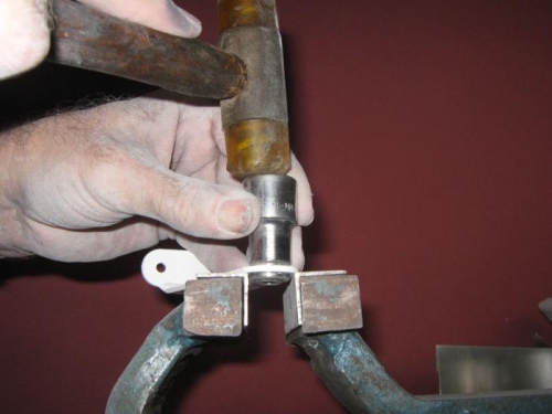

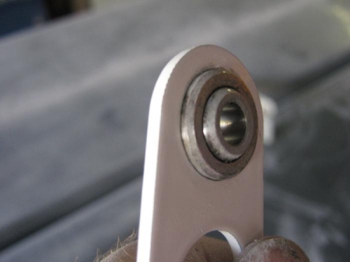

Brief Description:  Fitting bearings to aileron hinges
Fitting more bearings - aileron hinges this time. Getting better at this. Lightly sand the powdercoat out of the bearing hole in the hinge - trial fit the bearing and keep sanding until the bearing is close to fitting. Then put the bearings in the freezer for 30 mins or so - then tap the bearings in before they warm and expand again. Got good tight fits this time without having to peen around the bearing.

Using a 12mm socket to drift the bearings in
Mounted bearing.
Mounted bearing.
