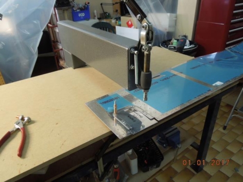

On that Sunday, I worked on the long aft fuselage side skins F824. I did:
- Dimple the dia #19 hole for a #8 screw which will fasten the rudder cable exit guide clamp, on both LH and RH skins
- Fitted the F-824B Cover plates on the F824 skins: Dimpled the nut plates rivet holes, then the cover plate attachment screw holes for a #6 screw, matching it with the cover plate at the same time.
- Then, I started the long process of dimpling dia #40 holes for flush rivets on both F824 skins. It takes about 3.5 hours for each skins. I did the entire left skin, and then in the evening, I did 75% of the right skin.
