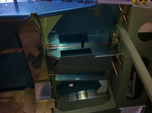

Brief Description:  Fuselage - New F-864A-1 fitting inside aircraft
Using the new front throttle quadrant support plate fabricated this Sunday, I started fitting it to the aircraft tonight. I replicated the holes for the top cover F864B-1 then fitted the cover onto the new support plate. Next step was to replicate the screw holes in the support plate common with the front angle and the bulkhead F804 screw location. It turned out the new plate fits all right. That is a good news !
Fitting the new F864A-1 replicated part
