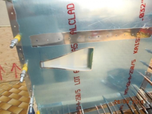

Brief Description:  Fuselage - fitting NACA Scoop on left side skin
I decided to start fitting the plastic NACA scoop on the interior side of fuselage Skin F820-L-1 right now. I am doing this at this early stage because I've decided to install this scoop not only with sealant used as glue, but also with solid 3/32 countersunk rivets. I want to take the opportunity later to dimple those rivet holes at same time I will be dimpling the skin panel. I will be much easier done this way.
Overall, (8) #40 holes were drilled to hold this scoop in place much sturdier than just with sealant.
