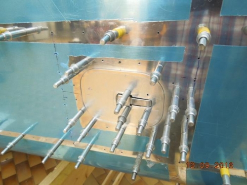

On this Monday, I tried to complete the External Power Plug Mod, working on the access door hatch. I did:

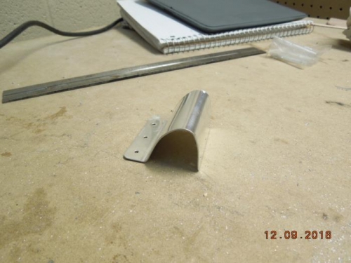

- From scratch, I made the hing offset arm from AL 2024-T3 0.032" thick sheet. I rolled the best I could the skin using my Boelube jar and a Snap-on socket to get the approximate radius. I bended the flanges with a steel ruler, clamping the part on the work bench.
- I test fitted the hinge assembly on the aircraft, and it works nice !

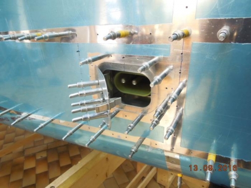

- I deburred the hatch door, trying to ensure a proper gap with skin and doubler.
- In the evening, I made the cut-out for the Hartwell latch, drilled it and test fitted it on the aircraft.
Next step is to finalize hinge and door installation.
