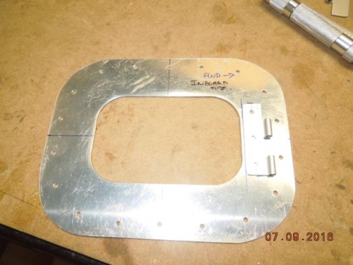

Yesterday evening, I continued on my side project to add supporting structure for an external power plug on left side of fuselage. In order to add stiffness to left fuselage skin, I created an angle made of 0.032" AL 2024-T3, 6.25" long. I located it and drilled holes into skin for future mounting with AN426AD-3 rivets.
Once this angle was located, I changed my focus toward adding a small piano door hinge to the doubler I had made this past week-end.
