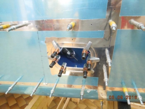

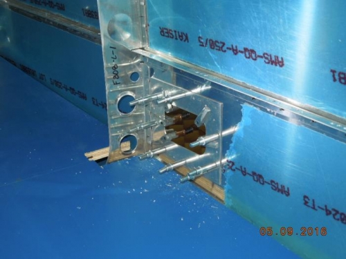

Brief Description:  Fuselage - MOD- External Power Plug Skin doubler
The last few days, I've been working to make a modification to my RV-8 fuselage. This modification is the addition of an electrical ground plug hatch and support on the left fuselage side near where the battery will be located
Today, I finalized laying out holes in my doubler, drilled them dia #40. Then I located the doubler inside the fuselage, and backdrilled the holes through aft fuselage left side skin. Once that was done, I removed the doubler, rounded the edges. I test fitted the Ground Receptacle support box on the doubler, and temporarilly installed the whole assembly inside fuselage.
