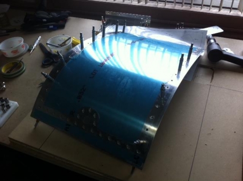

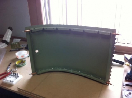

Date:  4-12-2016
Number of Hours:  3.00
Manual Reference:  DWG 84
Brief Description:  Fuselage - FWD Baggage Bay Door
Today, I continued assembling the fwd baggage bay door. First, I removed and replaced the flush rivets I unproperly installed night before. Then, I proceeded to install in place the top angle and the door hinge. I followed by riveting complete both fwd and aft door ribs.
At this time, the door is partially completed. I cannot complete the door until the fuselage fwd top skin is in place. This patial sub-assembly was completed well ahead of its need.
I worked on this from 15h00 until 18h00
Door partial sub assy completed for now
