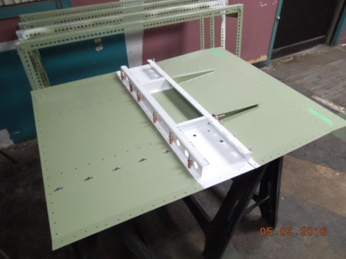

Date:  3-5-2016
Number of Hours:  4.00
Manual Reference:  DWG 60 & 61
Brief Description:  Fuselage - FWD Floor & Firewall sub assy
With strong confidence built from my experience the day before, again I decided to work on aircraft sub-assemblies instead of practicing riveting on the practice kits and parts. Therefore, I did:
A) on the FWD Floor sub assy (F-822):
- Finalized nutplate install on F802K & F802L
- Installed and rivet floor assy parts, back riveting them to F-822-1, except the F802K per instruction
B) on the Firewall:
- Installed nutplates on F801H-R-1 and F801F-1
It turned out nut to be a good idea to install the nutplate on F801H0R-1, at least for two nutplates as they were in the way for proper back riveting of angle to firewall web.
I worked from 16h30 until 18h03, then 19h45 until 21h45.
