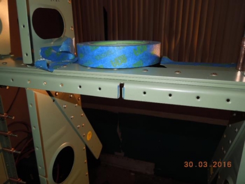

- Worked on Seat Rib rivet snags.
- The middle slot on F806B bottom flange was slightly enlarge as it was fouling with the rivet heat to be located in the slot. This rivet is installed to join F826 and F827 seat rib skins together. The slot was enlarge with a dremel cutting wheel, then file and deburr. Later, touch up primer was applied to it with airbrush.
Slot to enlarge in F806B to prevent fouling with rivet head ir dimple from skin
