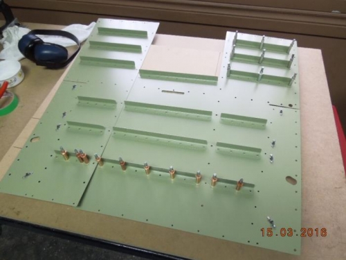

I did:
- Floor panel F831-1 assembly
- Floor panel F830-1 partial assembly
- Pax foot rest LH F829
