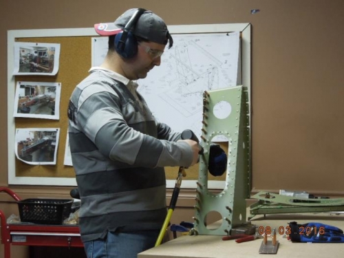

From 16h00 until 18h15, I worked on the L/H L/G tower assy. I installed nutplates on F802C and riveted parts to F802A and F802B L/H side
After dinner, from 19h30 until 21h30, I worked on the RH L/G tower, by final riveting the box together, then finalized nutplate installation on F802C LH and RH.
