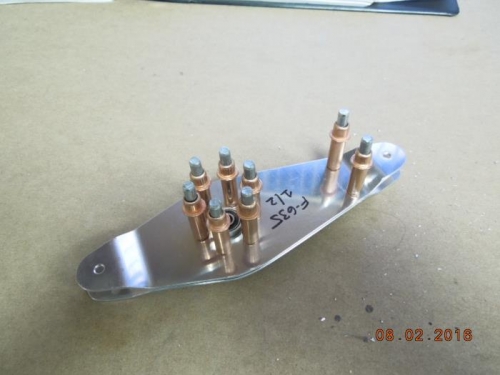

- The Quadrant F635 parts had been separated a while ago (in fact those where the first parts I worked on when I got the kit), and were already deburred, I only needed to match drill the parts together, then deburr the holes.

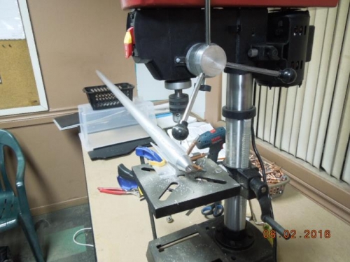

- On the F841 pushrod, I fitted the VA101 threaded ends, then marked per instruction the 8 holes to be drilled. I made sure to have sufficient edge distance on the aluminum tube. Once I removed the threaded ends after drilling, I realized I didn't push these deep enough inside the tube, and for most holes, I have a low E/D condition with some holes at 0.150 from edge. Considering this is a flight control part, I feel this is too marginal, and I will replace those VA101 threaded ends with new ones. Also per instruction, I cleaned the inside of the tube with naphta on a towel pulled with a string.
- Similarly, I matched the threaded ends with the F-840 tube, and drilled 6 holes per the instruction. This time, all E/D turned ok !

Enlarging holes in F635 quadrants
Drilling holes in F841 and VA101 pushrod assy
Drilling holes in F840 pushrod
