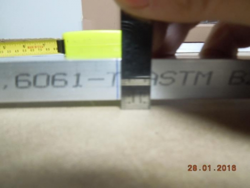

On this mid afternoon work session, I continued longeron bending with the auxiliary longeron F844 LH and RH.
This longeron requires a bend of 5/32" in his center. Van's instruction specify to make a slight bend every two inches from the center to obtain this curve in the longeron. Therefore, I made pencil tick marks along the longeron. I clamped the longeron in my vise, and made moderate hammer "wacks" at the tick line. I was surprised to find out how little hammering is required to bend this longeron to shape. I had reached or exceeded the 5/32". It was equally easy to remove the bend in the other plane, with a slight bend to make it flat again.

Proper 5/32
Proper 5/32" radius achieved
