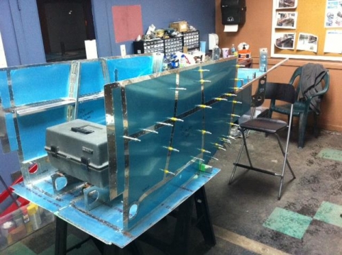

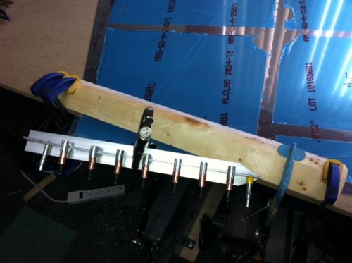

- Continuing on the previous day, I shaped the LH F823-1 Mid Fuse Skin, making the conical bend in the bottom aft corner. As with the right side, it went ok, and needed two bends, plus a little hamering to make it confirm with F807 bulkhead.
- I fitted the skin on the mid fuse with cleco, and installed all the intercoastals on it.
- At that stage, I had pretty much completed what I could do for now on the mid fuse, and started to look in instructions what would be the next section.
- I started going through instruction for Aft Fuselage Assembly (pages 8-23 & 8-24).

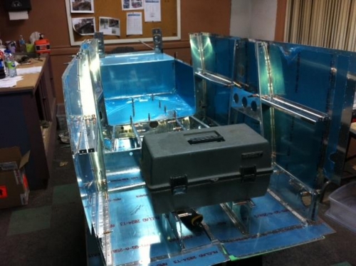

- I decided to install the bagage rib assembly on the mid fuse, using cleco on bulkhead F807. I continued my little "mockup" assemble to understand how the aft bagages panels are put together in the fuselage. Pretty happy I did that. then went for dinner
- After dinner, I disassemble my aft fuse baggage area mockup assembly
- With the bagage rib parts still clecoed together, I drill all the hole full size, then disassemble and deburred.

Mid Fuse mock up with baggage bay
Starting to look like an aircraft cabin
LH skin F823 aft bottom corner roll
