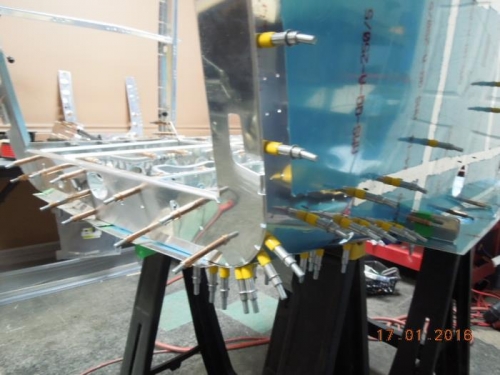

- Per instruction pages 8-18 & 8-19, we first match together skin panel F823-1 and F815C-R-1 with cleco

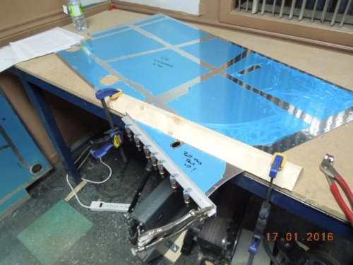

- Next objective was the bend the conical shape on the bottom aft part of F823-1. Per the instruction, we made bend line on the parts. Using the bending board I created a few days ago, we clamped the skin on the work table, and started bending the skin. We made 2 attemps to get the shape right. Then It was time for dinner, and we left it up there.
- I came back after dinner and finalized shaping the right side, then prepared the left side for shaping the next day.
Sylvain clecoing F815C on F823-1
Getting ready to make the bend on F823 RH
F823-1 skin finally matched with F807 bulkhead
