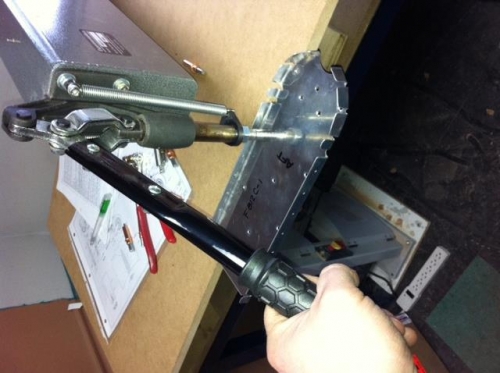

- On Bulkhead F812, I dimpled the dia #30 rivet holes on the aft face. I tried to dimple both parts together with the DRDT-2, but that was too hard.

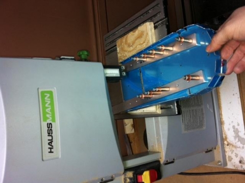

- Since I had been working on tailcone bulkheads, I decided to complete this section by starting working on the replacement F811A and F811E I had just received. I first started by thinking about a way to make the cutout I missed the first time. In order to have same cutout on both parts, I decided to clamp them together with cleco. I also decided to use the stab tail bars as guide to ensure I cut a straight line along the stab bars. That worked fine. The stab bars now only need a little polishing to remove saw blade scarring. This time, I got a perfect cut.
- I removed the blue film on both F811A and F811E, and match drilled all the dia #30 holes in this sub-assembly

Dimpling Bulkead F821E
Making Cutout in F811A and F811E at same time
