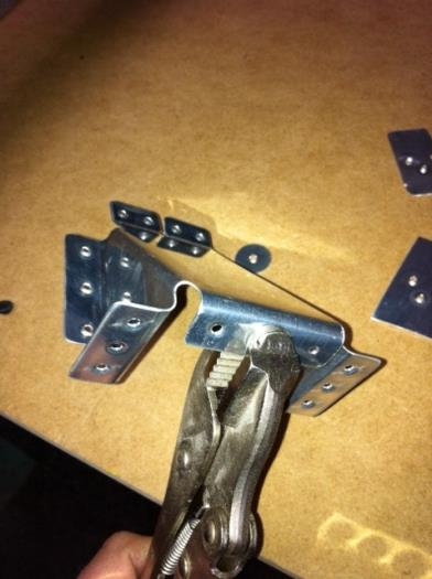

Despite being moody today, I think I have accomplished good things:
- On Bulkhead F807B-1, I finalized seatbealt harness fairlead installation prep by dimpling both the bulkhead frame and the fairleads together with the DRDT-2
- Similarly, I fitted the F882-1 Canopy rail receptacle on frame F807B-1, and dimpled both parts

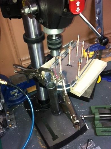

- Next step, after retrieving the tail wheel assembly and disassembly the WD809 from it, I started the process to locate the tailwheel weldment on the fwd face of bulkhead F812. It took me a while to find a solution to clamp it into place until I realized I have Vise-Grip clamps in my stock of clamps. I had purchase those maybe two years ago, but had never used them before !
- I drilled the dia #30 keeper rivet holes with the bench press, after again trying to find the best solution to mount it on the press drill table.
- Per the instruction, I then countersunk the dia #30 keeper rivets hole on the aft face of bulkhead F812, and stop there for the evening.

Dimpling Bulkeahd F807B-1 and Seat Belt Harness Fairlead
Dimpling F822-1 with Vise-Grip Dimpler where this is limited acess
Drilling Tailwheel Weldment throught F812
