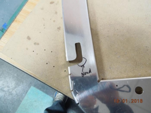

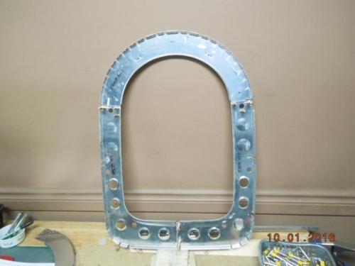

To move along with the instruction for Mid Fuse, I started working on the F807 bulkhad frame. I finalized some deburring by removing/blending a crack I had made with the wheel cutter when I removed the tabs in this parts during deburring phase. I then scuffed this area, followed by joining both LH and RH F807 parts at the middle with Cleco. This assembly was then fitted to the Mid Fuse now on saw horses. I installed after the F860 intercoastal on the Mid fuse side walls.

Blended this corner, which had been badly deburred

F807 bulkhead prior to fit on Mid-Fuse
