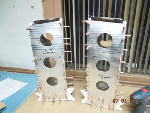

A) L/G Box Sub Assy
- Re assemble both L/G boxes on Cleco, to use them as mock-up to help bend F802D-1 L/H and R/H parts accordingly with L/G Box bulkheads F802A-1 and F802B-1.

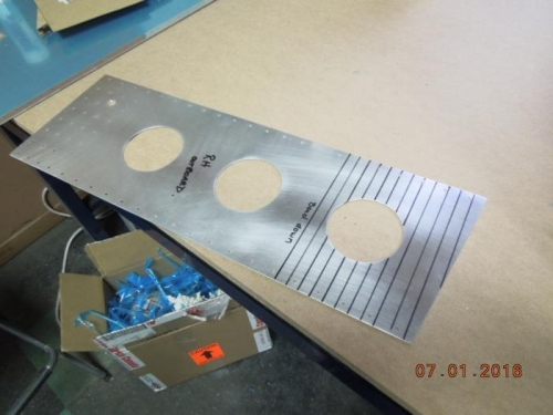

- On each F802D-1 parts, identify which one will be the RH or LH parts, then make bending lines with a sharpie pen every 1/2" inch from the top of part
- Locate the F802D-1 parts on the L/G Box, RH and LH

Bending reference lines on F802D-1
L#G Boxes fitted with F802D-1 on clecos
