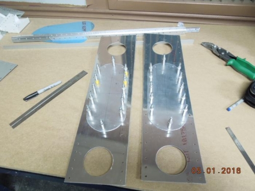

Today tuesday, I continued working on the L/G Box Mod for serviceability access with the modification of F802C-1 L/H and R/H L/G Box web. I did:
- Located the homemade Access Cover Plate on the R/H L/G Box Web, and clamp it into place.
- Match drill dia #40 the R/H Cover plate thru the previously drilled holes in L/G Box web F802C-R-1, installing a cleco in every hole as I drilled
- Once match drilling dia #40 was complete on the R/H, I moved on to drilling full size dia #19 on both L/H and R/H assemblies.
- Following this, I unclecoed both assemblies, removed the remaining vinyl film on the homemade access cover aluminum plate, and deburred all dia #19 holes in both covers and F802C-1 webs L/H and R/H.
I worked from 15h45 until 18h10
F802C-1 LH & RH covers matched drilled dia #40
Same as previous, but now drilled full size dia #19
