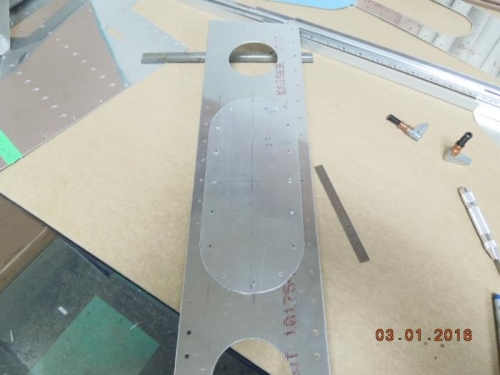

Brief Description:  Fuselage - L/G Box Mod - Access Hatch
HAPPY NEW YEAR 2016 !!!!
Today, I was back working on the RV-8 after a few days of break. It is sometime good to leave the project alone for a few days, rest and get more motivation to keep on going with the pace I've had this fall...
Therefore, today was a small work session dedicated to progress on modifying the F802C L/G Box webs to add a cover, or access hatch on top of it. I did:
- Finalize the second cover
- layout and drill pilot #40 holes in one cover
I worked from 16h00 until 18h00
