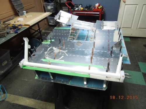

On that Friday, first order of the day was to unwrap replacement parts received from Van's aircraft that day (See next post for Shop supplies). Then with new parts in hands, back to building the airplane....I did that day:
- In the replacement Flap bearing block part F445, I drilled pilot holes dia #40 in the press drill, but now using a newly purchased press drill vise to hold my part.
- Next, I drilled full size dia #10 in both flap bearing blocks F445 per reference DWG 77.
- F445 bearing blocks were fitted on W806 Flap actuator weldment
- F830-1 & F831-1 floor panel were re-installed temporarily on the seat rib structure
- F445 blocks & WD806 flap actuator were bolted to seat rib structure with the back hole in F445 blocks and bolts per DWG 77.
- I matched drill F445 front hole with seat rib structure

Flap actuator weldment WD806 pre-fitted on seat floor
