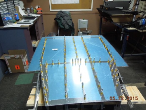

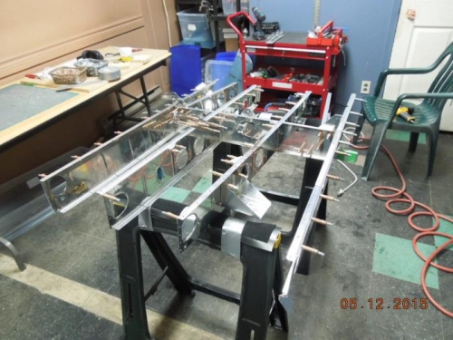

On that Saturday, I made progress on the Seat Rib Sub Assy:
- Re-assemble all the Seat Rib Sub Assy on cleco
- Drill the interface with Spar F806
- Removed blue vinyl film along rivet line on skins F826-1 and F827-1, and fluted flange on F827-1 per instructions
- Following that, I cleaned the saw horses (they came from outside in the garden) and added carpet on them to prevent part damage
- I spend a few minutes to install no marr boots on 100 cleco 3/32
- I located the seat rib sub assembly upside down on the saw horse
- Cleco both skins F826 and F827 on the seat rib sub assy.
- Later that evening, I match drill skins F826 & F827 with Seat Rib Sub Assy
- Removed the skins from the seat rib sub-assy
- Deburred all holes in skins and seat rib sub assy
