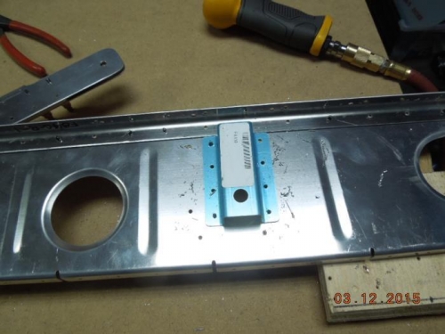

On that work session, I did more Seat Rib Sub-assy action ! This sub-assy is very insteresting to work on. I did that day:
- Drilled full size angle F814C-1 and F814A-1 Inboard seat rib, both side LH and RH
- Drill all hole full size in Rear spar sub assy F806
- Located with pilots holes in F814A-1 LH & RH the brakets F8110 & F8111 for Aileron Electric Trim Servo and actuator.
- I match drilled full size F8110 and F8111 on the F814A inboard seat rib.
- Later that day, I disassemble everything, and deburr all holes.

Aileron electric trim part F8111
Match drilling F8110 on F814A
