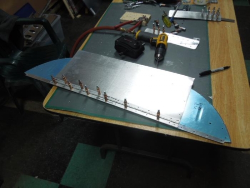

Brief Description:  Fuselage - MOD Avionic Access door in F866B-1 Bulk
I continued working on this modification for avionic access through bulkhead F866B-1. On that day, I fabricated the cover door with 0.025 aluminum and made a matching piano hinge with door and holes found at bottom of F866B-1 and corresponding to F802N-1
I worked from 16h30 until 18h00, then from 19h45 until 21h30.
NOTE: Following completion of this mod, and long discussion with my Dad and other person visiting my shop the next day, I decided that this modification was not to the standard I want to achieve with this aircraft. This modification, although well executed, does not represent a technical solution that would be used by a OEM aerospace manufacturer. It was decided on Nov 29 to discard this modification and come back with a new design at a later time.
