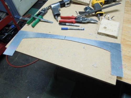

I continued working on the avionic access hatch in Upper FWD Baggage Bay Bulkhead F866B-1. On this work session, I did:
- Finalized the cut-out in F866B-1, and deburred the cut-out
- Started to fabricate a doubler to give strenght for modified F866B-1 bulkhead
- Cut doubler in 0.040 Alum 2024-T3 sheet, and deburr
I worked on this from 13h30 until 18h00, then from 19h00 until 20h30
