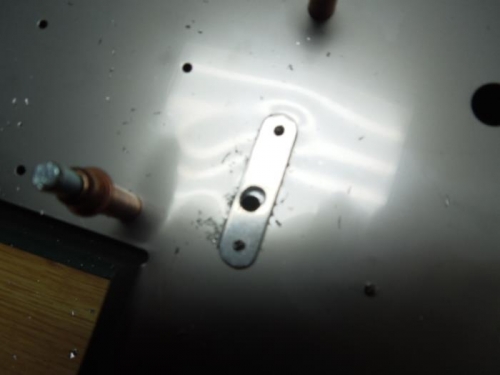

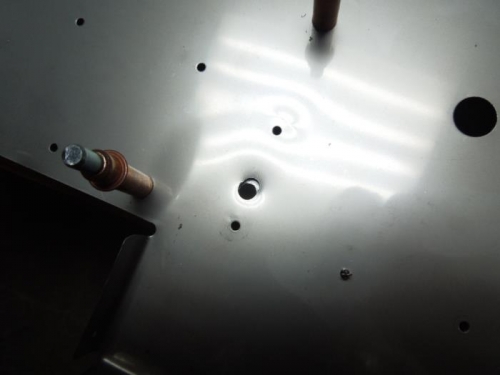

Problem: Hole dia #1/4 drilled as per ref DWG 60 is low edge distance in angle F801H-L-1 and ovalized in F801L-1 and firewall web F801A-1.
Causes for problem:
- External pressure to complete work quickly
- Firewall sub assembly structure was held at an angle, not allowing the drill to be perpendicular to web surface
Engineering disposition to solve problem:
- Re-order and replace parts F801L and F801H-L-1 with new parts
- Drill oversize with Unibit 3/8" dia the ovalized hole in Firewall web to make round again.
