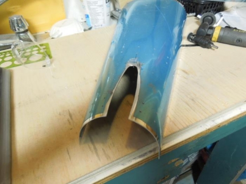

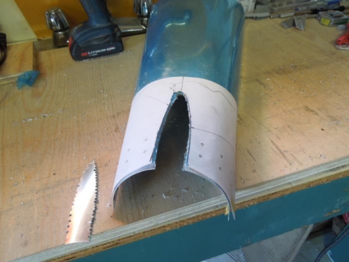

Brief Description:  Tailcone cut-out and nut plate install prep
Deburring is now definitely over, and I have moving on to another phase of fuselage assembly preparation with nut plate holes and countersinks. On that day, I did:

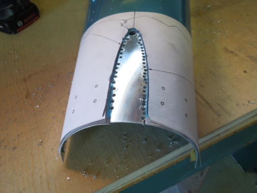

- F828-1 Tailcone skin opening for tail wheel arm (ref: DWG 73)
- Match drill parts F805D-L-1 and F805D-R-1 with F814A-L-1 and F814A-R-1 (ref: DWG 65)
- I sorted all parts with nutplate holes in stock and isolated them
- Drill #40 all nut plate rivet attachment holes in parts previously sorted, and deburred holes.
- Machine csk for nutplate holes following parts:
