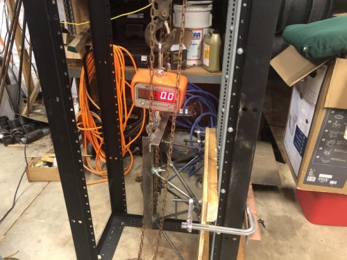

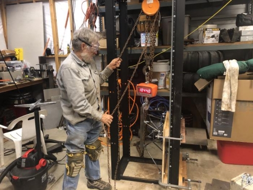

Brief Description:  adapted server rack as pull test fixture
adapted server rack as pull test fixture for stress testing of motor mounts. will attach the welding fixture firewall side to the server rack, and use a chain fall with a crane scale to exert a measured pulling force on the motor mount. Following the example posted by Axel on his web site.
