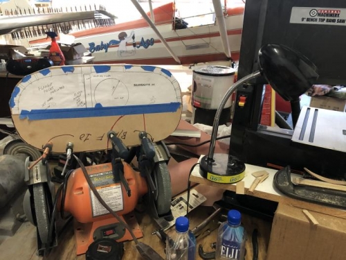

Brief Description:  cut out aluminum blanks for B/H 2 4 9 10
Trimmed form blocks to full size for aluminum blanks for bulkheads 10, 9, 2, and 4. Next step will be to trim off the flange allowance from the blocks after removing the aluminum blanks from the sandwiches, and rounding off the edges for the radius of flange bends.
bulkhead # 10
bulkhead # 10
