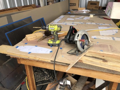

Brief Description:  cut out MDF for fuselage bulkhead blocks

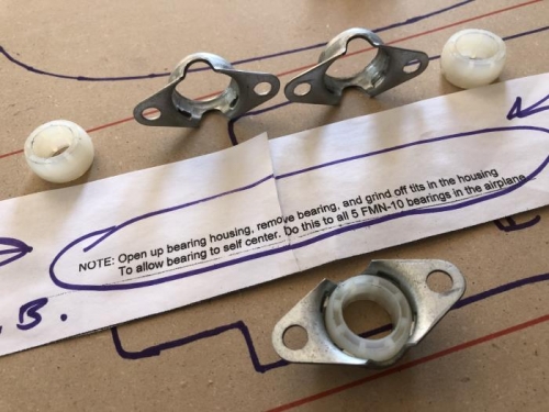

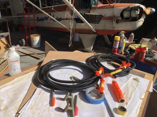

Spent most of the day cutting up a sheet of MDF into pieces for making form blocks for the fuselage bulkheads. Took most of a 4 x 8 sheet. Also made up some electrical conduit with pull strings inside to build into the wings. I don't intend to install wingtip lights in the beginning, but want to keep that option open for the future. Modified the control system bearings in accordance with instructions in Dave's plans.
cut out MDF rough forms for making bulkhead blocks
flexible electrical conduit with pull strings for future wiring
modified nylon bearings for better self-centering according to plans
